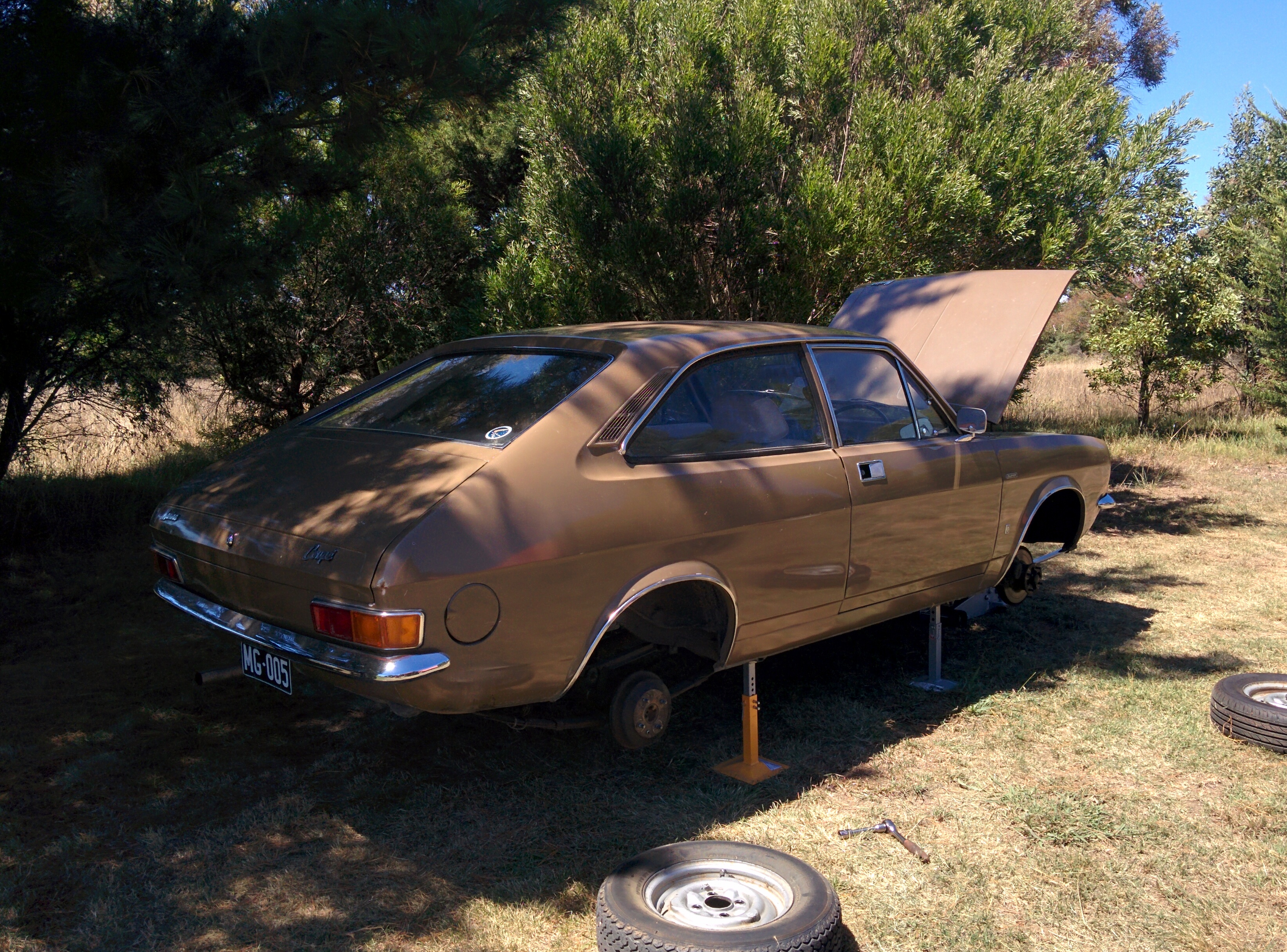

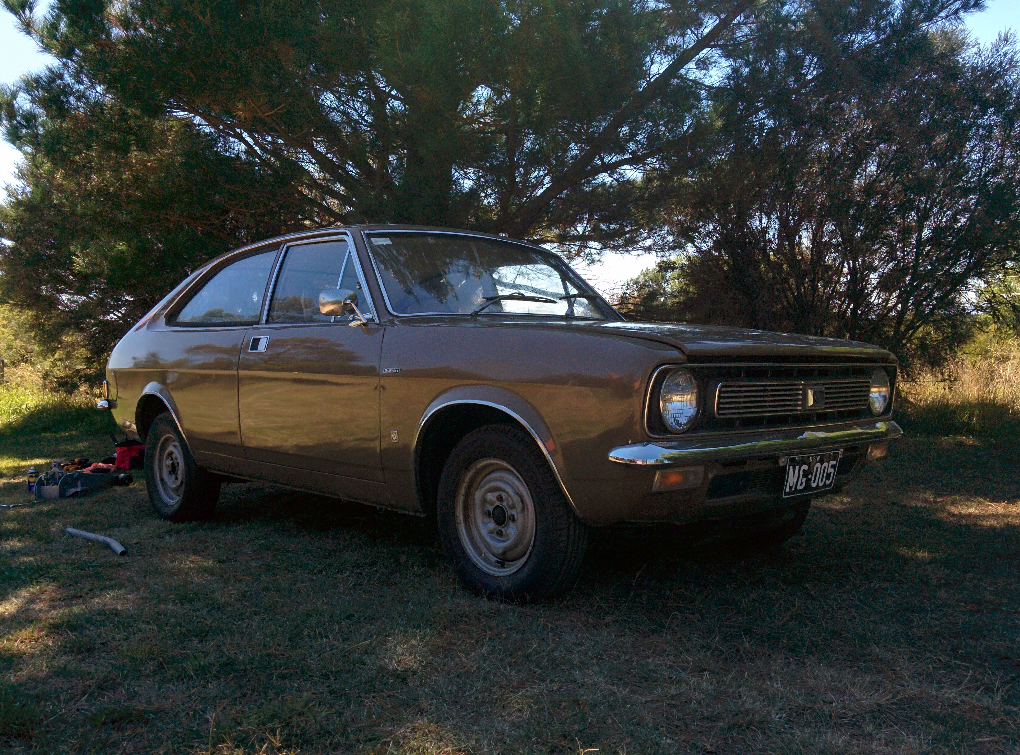

I thought I'd just post a quick introduction as I've newly signed up. I'm helping my Grandpa restore a Marina that he bought recently. I don't really know anything about Marinas, but I have worked on a few cars. It was a bit rough when he got it, I changed the spark plugs and bled the brakes and it goes surprisingly well.
The car is a four cylinder Coupe, but has a 'Super' badge on the side, which I thought meant it should be a six cylinder. I'm finding it difficult to find reliable information on the internet! Would somebody be able to point me in the right direction for information? I'm currently trying to figure out the part number for the steering rack as it needs replacing.
The chassis number is YH2S7610 (or possibly YH257610). Can I decode this to figure out the car's original specs?
Sorry if I've missed anything obvious and thanks in advance for any help!

I haven't inspected the steering rack closely, but I could feel a clunking from near the boot when moving the left wheel by hand. The local mechanic reckons the steering rack casing is cracked.
