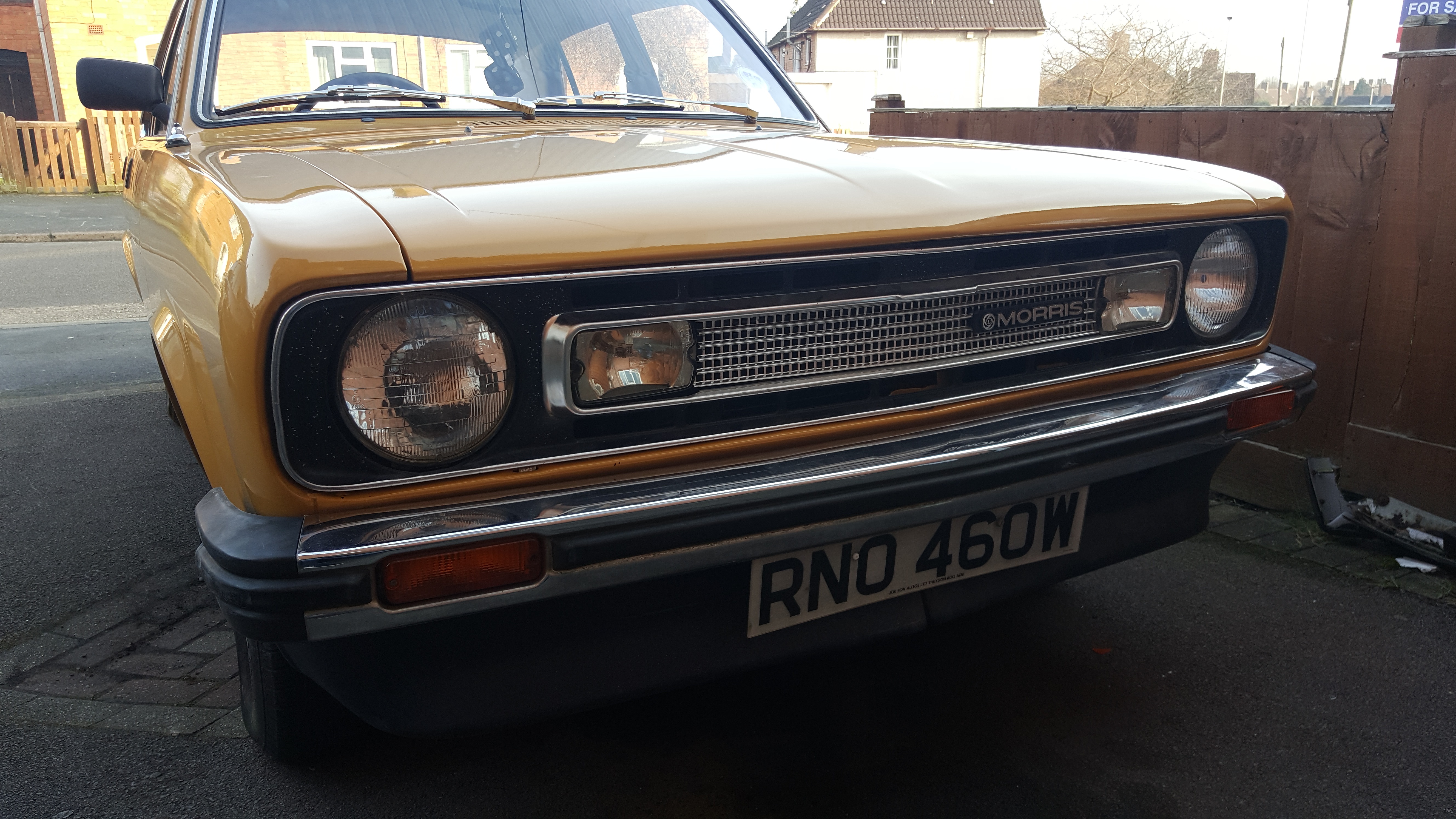

Post by Brenjacques » Fri Mar 11, 2016 6:43 pm
Hi, I finally got the car back today and I am very happy with it? It looks as if nothing has ever happened! They also matched the paint and gave it a clean and polish. I only have this photo at the moment as I have had to rush it to another garage to get the mot done (and it really needs some work doing for that)! So there we are, turns out it was worth saving, let's just hope the cost of the MOT work is cheap as I am now skint :lol:
Re: Is this too far gone or worth saving still?
Post by JoshWard » Fri Mar 11, 2016 6:49 pm
Wow, great result :-D
