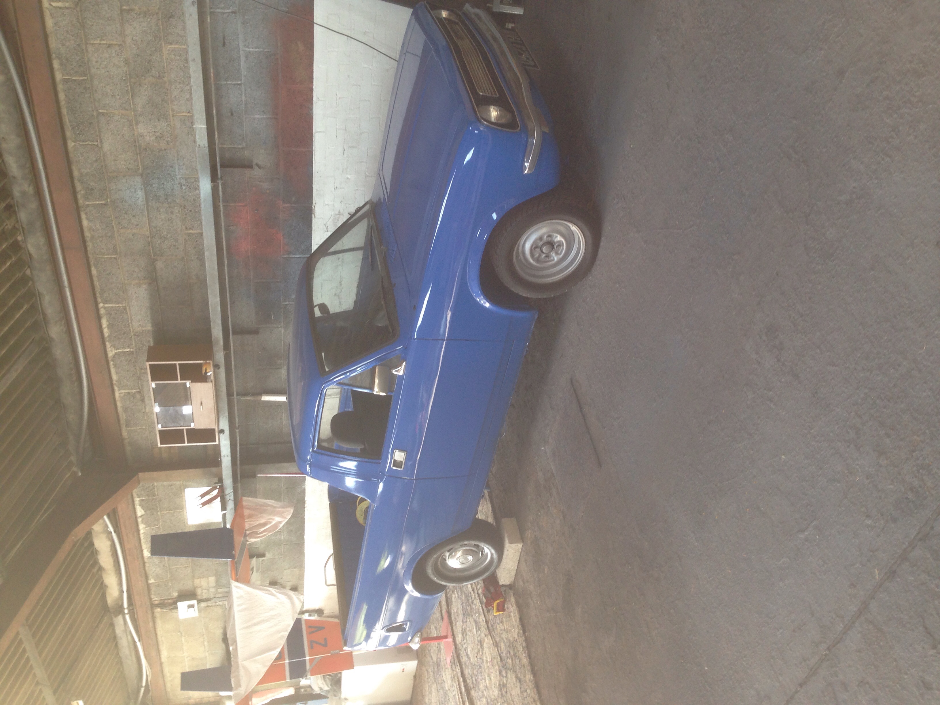

Here's my Pickup.

Your pickup looks great , especially like the wheels . I don't have a clue why my picture turned sideways !!

Your Mk2 looks lovely, I'm using Tapatalk on my iPhone and your picture is the correct way round.

I based my identification as a Mk2 based on the front bumper and sidelight/indicators. Mk3s are different. The grill you have used is from a Mk2 1.3 saloon or coupe. The Mk2 grill should be the same as a Mk1, with the split grills and the vertical centre nose, check the brochures the link is below.

The body is as I bought it Chris. The front suspension has been changed for the 1.8 I would think as it has discs fitted and 14 inch wheels whilst the rear are drum and 13 inch . So another requirement will be one of each for spares !! The chassis plate appears made up so would imagine the MOD had it without one and DVLA invented one when it was first registered on civvy street . Chris .

Disks were an option, and standard from Nov 1978, all original Pickups came with the heavy duty front and rear suspension. 1.8 saloons and coupes used the same softer spring rate as the 1.3 saloons and coupes. If you swap the front 4.5" PCD hubs to saloon 3.75" PCD hubs you will have the same stud pattern all round. This is what is on Barmy's white Pickup.
