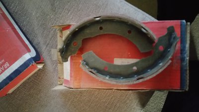

Hi All,
I'm planning to change my brake shoes this weekend as I've had enough of squeeky brakes. However I've just inboxes the shoes I brought and not sure if they are the right ones... due to go onto a Mk1 1.3 saloon.
Are these the right ones?
Cheers
Lewis

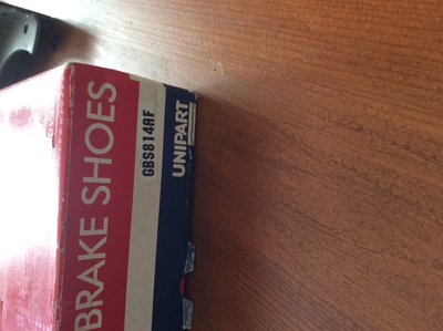

Sorry that would of helped....
They are supposed to be for the front. I believe they are gbs162
Regards
Lewis

Post by JoshWard » Sat Jul 23, 2016 8:01 am
The changeover for the front shoes was chassis number 291007 to 295000 & 302538 onwards. If your chassis number is below 291007 you will probably need the earlier type.

Post by aqua-marina » Sat Jul 23, 2016 1:53 pm
JoshWard wrote:The changeover for the front shoes was chassis number 291007 to 295000 & 302538 onwards. If your chassis number is below 291007 you will probably need the earlier type.
As josh says you probably need a set like these

Post by Lecozens » Sat Jul 23, 2016 2:04 pm
Have ordered a new set, like the ones you posted aqua marina. Another week of squeeky brakes it is then :(
Just to double check, the correct ones are the same as an escort mk1/2?

Post by aqua-marina » Mon Jul 25, 2016 7:28 pm
Lecozens wrote:Have ordered a new set, like the ones you posted aqua marina. Another week of squeeky brakes it is then :(
GBS814 unipart shoes up to chassis no
302537
Same shoe fits various fords and vauxhalls
